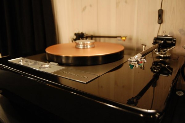

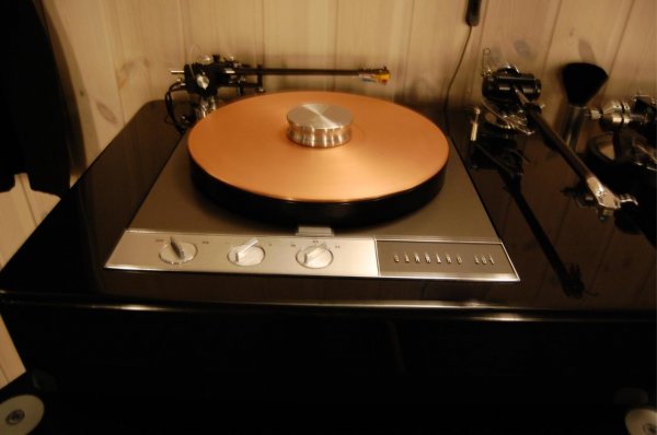

I have completely restored a 401, pretty much all out now with new bearing and 12kg brassplatter and copper mat. Artisan Fidelity idler wheel and Loricraft powersupply.
Sounds better than my TWAcustic Raven on rock music, but most of all, the pleasure of having put down so many hours and love really makes it a joy to have.

Simply Awesome. You touch on something few people mention, the pride of ownership of such a machine.
