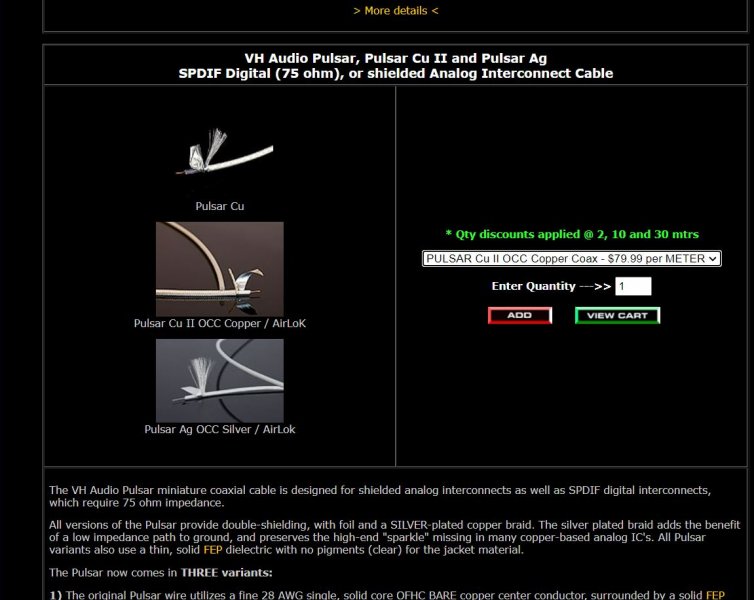

I am thinking about the manufacture in D.I.Y of RCA Modulation cable with VH audio cable, I am a French audiophile and I have few feedbacks or opinions on comparisons of VH audio modulation cables, we mainly have Neotech , Gotham, the best known in D.I.Y
I hesitate between 2 cables and I would have had your opinion as a point of comparison which on this forum should not be missing
here are the 2 references that I retained
- UniCrystal™ OCC SILVER Wire w/ Cotton Insulation, and HyperFlex™ Tubing
- VH Audio Pulsar, Pulsar Cu II and Pulsar Ag

It depends upon your funds, but the Pulsar is a 75 ohm cable, it's for digital and video signals, so it's out of the running, IMO. Chris just came out with his new VH Audio V-Twist™ Cu24 Analog Signal Cable. I have been buying his capacitors for over a decade. I believe that he is relentless in his pursuit of quality sound. I actually have a pair of cables that I purchased from him, my first cable purchase from him, but due to my work schedule, I won't have a chance to listen to them until Sunday at the earliest, so my opinion is based on his past performance with capacitors for now. I would forger the Pulsar, buy the new V-Twist, and if I could afford the money and storage space, I'd get the silver cable too, and see which one I prefer. Yet if I were to be completely honest, I'd ask Chris. He's in business to provide us services, and he is relentless in his desire to please, in my experience. Let him know what you have, and what type of presentation you are looking for. Silver is said by many to be bright. I have not tinkered enough with it to know. One silver IC I did purchase sounded thin, I was not impressed, but Chris' wire may have completely different characteristics. I have pretty much settled on using copper, but I may be cheating myself. I didn't follow my own advice and consult Chris, I just ordered copper out of habit, now that I think about it I wish I had asked him! Anyway, he wants you to be happy, and to recommend him to others, so he's going to tell you his honest opinion, and hope that it makes you happy and that as a result, you'll tell others about your positive experience dealing with him. I'd use Eichman/EIT RCA connectors, they fit tighter than any others, but again, as Chris. I am pretty sure that he used those on the cables he made for me. I'm not sure that he has the new cables on his site yet, I had ordered the older style and he offered me the upgrade. I am sure that Chris will be quite helpful.

indeed chris had proposed me the Pulsar 2 Cu to realize the RCA cable because he had asked me if I needed a cable with a shield and it's maybe for that reason that he didn't propose me the VH Audio V-Twist™ Cu24 analog signal cable
