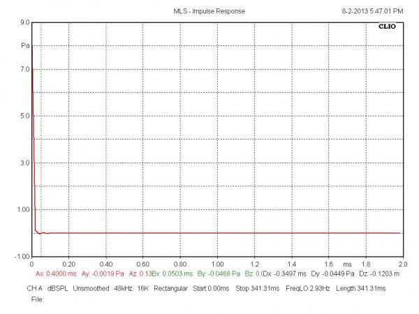

Just for fun here is what an inexpensive interconnect cable looks like measured on a CLIO test set-up. It is looped between the output and the input port. The cable is a no name you could purchase at Radio Shack for a couple of bucks. The first is the impulse response the second is frequency response and phase.
You get what you would expect.
Rob:)

Great stuff. Do you have any multi-thousand dollar cables lying around to compare it with..?
Do you have any multi-thousand dollar cables lying around to compare it with..? .
Hello Groucho
No:D
The "best" I own are Straight Wire Symphony 2's. Hardly going to break the bank with those. It looks the same, very little difference at all measuring a 2 meter interconnect. Almost the same exact phase change above 1K even with different construction.
Rob:)
Rob:)
And what else should we expect from this test? :confused:
Perhaps you can repeat it with a cable costing only a few cents.
Hello Micro
That is what the test shows. That cable is as cheap as you can get
Rob
Not sure what you're saying, micro. If you're a believer in expensive cables, wouldn't you expect some signal loss or degradation from this test? If this is what you would expect from a Radio shack cable, what is it that cable believers expect from expensive ones?
Tim
