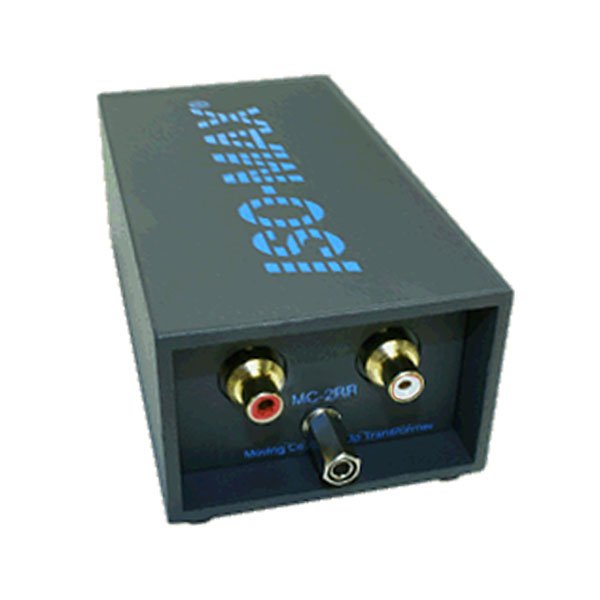

I use this (Jensen Transformers) with a Lyra Olympos SL mono cart, .15mV output, plugged into the MM input of my phonostage(s). +32dB. It's the same transformer that is direct coupled in my Lamm LP1 Sig phono stage for the hi gain MC selection. Dead quiet, neutral sounding and a real sonic bargain.
http://www.cs1.net/products/jensen_transformers/MC-2RR.htm

So you don't lose any Lamm magic if you put these ahead of the Lamm?
Nope. While not a member of the Lamm Signature club, I've had great results with my Koetsu and My Sonic Labs SUTs into the MM of my LP2 and LP2.1s.

Interesting, I wasn't aware of this - it does sound like a bargain. David is the same Jensen you were referring to?
For this price I might get it to hear what it does to the sound of my A95 through my CAT phono.
