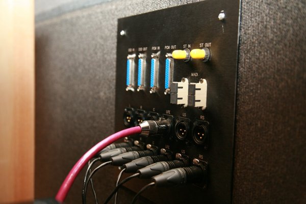

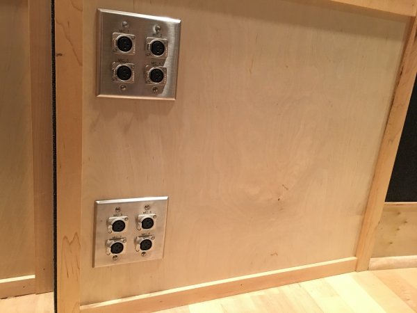

To cut down on the many cables that are used, I have mostly DB25 cable looms. One cable for 8 mic feeds. Also, I have hardwired most of my connections to cut down on clutter.
As noted above, I also use the Dymo label maker to put on the ends of my XLR cables.
