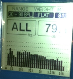

To get right down to it, we spent a considerable amount of time trying to get the speaker to sound as good as it could in the room. I suggested bringing the speaker in a good distance, but Mike identified the spot that worked best from previous experience. We had the benefit of using a simple Phonic frequency analyzer with pink noise to get the best rough-in position, but it was not until much later that we made small position changes (<1 inch range) that allowed the speaker to sound its best (see Fig 1 (initial placement) and 2 final placement). (Note space between horiz dashed lines on meter face is equal to 5 dB).
So what exactly did it sound like? The answer is that it sounded quite good. But unfortunately, the room was not yet treated with the sound absorption materials that are currently on order. Thus, no matter what we did, there was a considerable suck out of 40 Hz that put a room stamp signature on what we heard even though we were able to achieve a fairly smooth response throughout the rest of the range . The main result of this is that the speaker’s sound lost considerable weight as a result of the 40 Hz suck out.. This defect in a key part of the bass range was also unfortunately aided by the fact that the speakers were on Teflon sliders and not spikes. Therefore, full-throated orchestral material, brass bands and even solo classical piano lacked the “weight” that is often a desirable characteristic of a true full range speaker. The rest of the range however sounded quite lovely. The McIntosh single chassis tube preamp and the Mc 2301 tube amps presented a very coherent, seamless sound field. It was hard to find fault with the speaker other than the obvious room boundary effect at 40Hz even though the Aida was not heard at its best. I have been fortunate to hear the speaker under stellar conditions twice previously. The first was at the ARC demo at CES. Drop dead stunning. The second, and possibly even more impressive, was at David Zucker’s Sound Experience in Boca Raton Florida about a month ago. David has a smaller room, and used a superb amp from Zanden Tandem (with which I was previously unfamiliar) to extract simply magical sound from the Aida’s. One can only hope that when the Aida is best set-up in its completely optimized room at LMC, it’s significant merits will be fully apparent.
