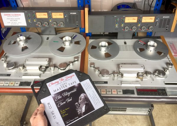

Hi from Mike at Chasing The Dragon! We have several A820s and over the years I have found them to be like race horses! They are very jumpy and need the right diet and TLC however, when you love them and look after them properly there is no other machine like it in the world! The most important thing you need is an engineer who really knows their way round the machine. Many people claim to know what they are doing but in reality it requires quite a specialized knowledge to keep them on song. Once you have found that person ideally you should try and marry them!
Over here in the UK I use a chap called Petronel, who runs the Audiophiles Clinic and having gone through many engineers, he is without doubt the very best. All of the electrolytic capacitors, pinch roller and bearings etc have been replaced in our machines and the sound quality is now, because of the more modern components, even better than when the machine was new.
As a matter of interest, I have bought a machine from Fred Thal and found that in comparison with a good second hand machine completely updated by Petronel (at a vastly reduced price!) sounded far superior and I can therefore through personal experience, heartily recommend that approach.
Good luck and if you have the time please enjoy the website: www.chasingthedragon.co.uk
Kind regards,
Mike Valentine
