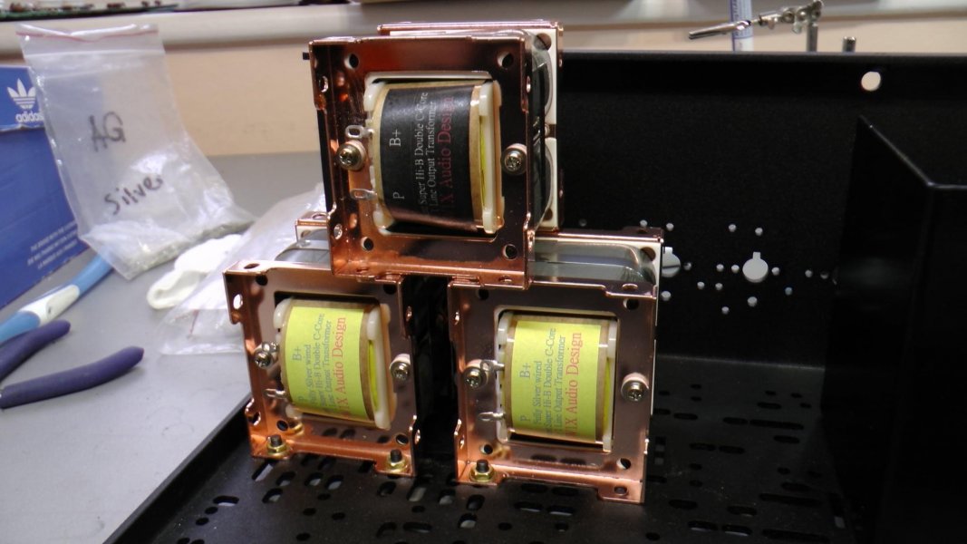

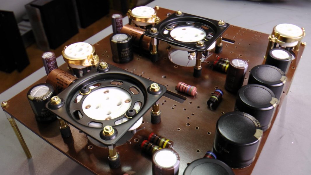

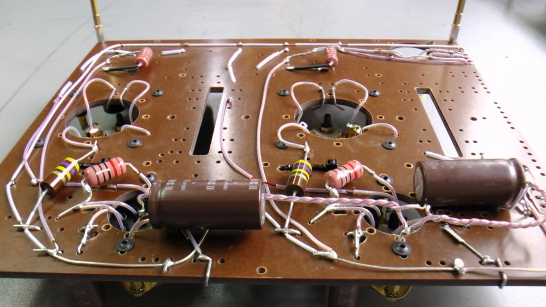

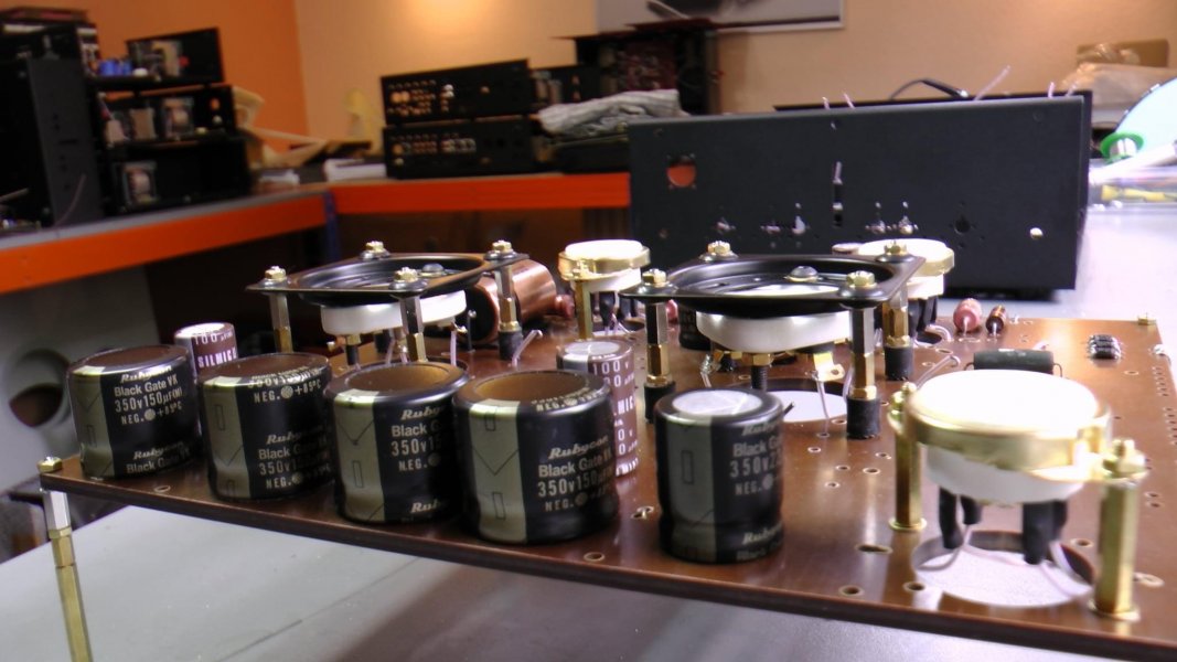

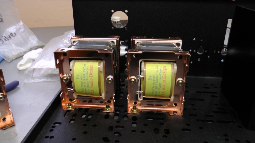

Custom SW1X DAC V with pure silver wound output transformers under construction for our customer. 0B7251D0-E194-464B-BD8B-07F68724ABAA.jpeg B1E98D1A-003B-4C42-95C1-4DF3D0E53B57.jpeg AC0F67E0-9C9F-4647-9354-9569A9B6758A.jpeg BAA73506-BADA-40D1-A48E-0CC75AAE343D.jpeg F706C62B-9DB4-45BA-AF91-F173E6612BEC.jpeg

The board in the photos is Panzerholtz and will house a section that is all hardwired.
