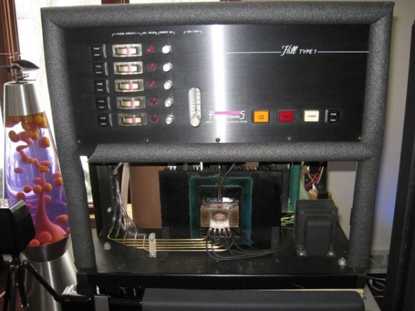

Hill Plasma
IMG_0453..jpg This in my opinion should be one of speakers on your list. While it is very impractical, the Hill Plasma from 700 hz to 100,000 hz provided the most accurate, extended high end, with transient response that even todays best speakers can not beat!!!!! View attachment 1307
Never heard one but I must say this is a very impressive thing ... I would like to know however how you came to that conclusion? I have nver read a review about this ..err.. speaker .. Isn't it dangerous .. really? No ions clouds or ozone ..etc ?

Frantz-If memory serves me correctly the Hill Plasma tweeter generated lots of ozone which is one of the reasons it never became a commercial reality. There were certainly others. So, because this speaker was a flash in the pan and never a serious commercial product owned by more than a handful of people, how can it qualify as one of the most significant speakers of all time?
Frantz: Check your TAS's. Pretty sure HP reviewed the Hill's because seem to remember a comment about having rocks in the woofer cabinet?
Mark's right too 'bout the ozone :)
bwraudio
Jan 24, 2011
54
1
#19
The Hill Plasmatronics avoided the air polution hazard by having its own built-in supply of helium, which is a noble gas and thus unreactive even when ionized. Helium is also biologically inert, and being much lighter than air, promptly escapes to the upper atmosphere. Even in the best-insulated houses it will be gone in a matter of seconds, so it is completely safe. Peter Moncrieff of International Audio Review tested this plasma transducer in the late 1970's and claimed that it was the best transducer ever produced. The problem came about when one set the flow rate of helium too low (helium is very expensive) and this could then cause ozone to be a problem. One other area of concern was possible eye damage (ultra-violent) from looking looking directly at the burning plasma. Also the woofer that was used did not keep up with the plasma driver.
MylesBAstor
11,223
7
585
New York City
#20
I seem to remember that being one of HP's complaints. Now gotta look out that review.
