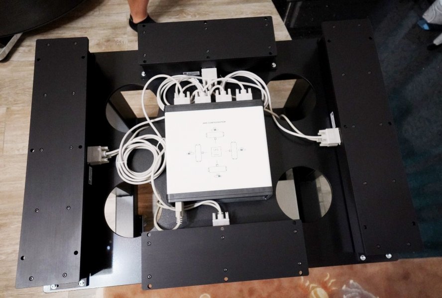

I have been using Herzan TS-150 active isolation platform for TechDAS Air Force One Premium for a few years and is very pleased with the sound. Recently I upgraded to Herzan AVI system with LFS, low frequency sensor. It comes with a custom-made steel table made by Herz in Japan and consists of four AVI modules from Swiss. The scientific officer in my local dealer said the AVI system with LFS is the best isolation technology currently available, and it meets the most stringent laboratory requirement for vibration isolation. The performance is much better than Herzan TS-150.
My question at the time was is it a overkill for hifi system? The scientific officer said he doesn't know as no one has tried before.
The isolation table was delivered last month. The low frequency sensor (LFS) is an add-on module which basically is a very large accelerometer (vibration sensor) specifically designed for low frequency down to 0.5Hz. It enhances low frequency correction ability of the AVI system. Low frequency vibration is particularly difficult to correct and is most ineffective in passive system. The LFS comes with a separate power supply and control module which user can turn on and off to compare the difference. In my system, the difference is very obvious with and without LFS. The articulation, dynamics and bass punch are noticeably better with LFS on. The whole package is much better with previous TS-150, so it is not a overkill for hifi. WhatsApp Image 2020-11-07 at 4.15.30 PM.jpeg

I like to keep hifi equipment to the side leaving the space between the speakers open. The imaging is better with this placement but it means the turntable is directly between a speaker. Vibration isolation is vital in this situation for good vinyl sound.
I have been using Herzan TS-150 active isolation platform for TechDAS Air Force One Premium for a few years and is very pleased with the sound. Recently I upgraded to Herzan AVI system with LFS, low frequency sensor. It comes with a custom-made steel table made by Herz in Japan and consists of four AVI modules from Swiss. The scientific officer in my local dealer said the AVI system with LFS is the best isolation technology currently available, and it meets the most stringent laboratory requirement for vibration isolation. The result is much better than Herzan TS-150.
My question at the time was is it a overkill for hifi system? The scientific officer said he don't know as no one has tired before.
The isolation table was delivered last month. The low frequency sensor (LFS) is an add-on module which basically is a very large accelerometer (vibration sensor) specially designed for low frequency down to 0.5hz. It enhanced the low frequency correction ability for the AVI system. Low frequency vibration is particularly different to correct and is most ineffective in passive system. The LFS comes with a separate power supply and control module which user can turn on and off to compare the difference. In my system, the difference is very obvious with and without LFS. The articulation, dynamics and bass punch are noticeably better with LFS on. The whole package is much better with previous TS-150, so it is not a overkill for hifi. View attachment 73005

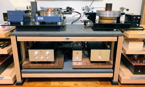

Let me spill the beans and reveal the secret of my good friend TLi to WBF brothers :
The AVI active anti-vibration table is for TLi's soon-to-arrive Air Force Zero turntable!
