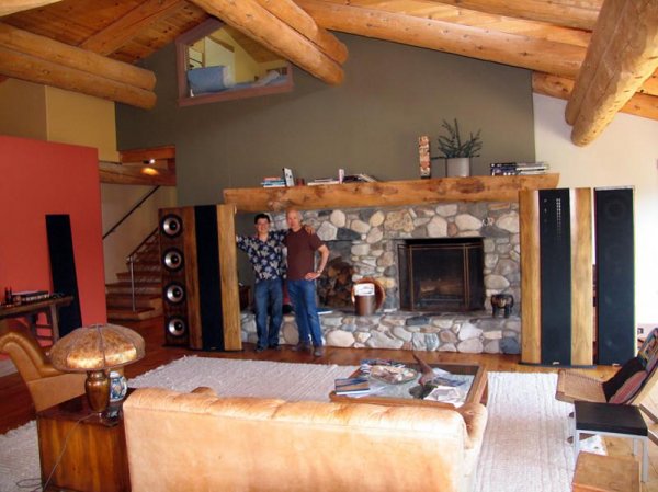

A happy customer with a completely upgraded Genesis II - woofers, servo-bass amps, cables, internal wiring, crossover, midrange, tweeters. The speakers are so old that the veneer is bleached by direct exposure to the sun, but the cabinets are still in superb condition.
We had to make the woofer holes bigger, drill new holes for re-wiring, but the 17 year old loudspeakers are now better than new!!

It is a magnificent room. Both husband and wife are real music lovers. Except for the power amps which are hidden behind the speakers, all the electronics (plus 10,000 LPs and about as many CDs) are in a room behind the green wall.
Source is the Goldmund Studietto with T3 arm and the Jadis CD player + Jadis DAC.
Totally un-audiophile, but the system was extremely musical. I tuned it for NO sweetspot. They weren't interested in soundstage and imaging, and wanted it to sound the same anywhere in the huge living room.
Does that mean you "detuned" the system? :)
garylkoh
Sep 6, 2010
5,501
96
545
Seattle, WA
www.genesisloudspeakers.com
Absolutely not. It was more difficult than to tune for one sweetspot, or even a love-seat. I had to make sure that there were no hot spots in the room and there wasn't a "hole" in the middle. The trick was to use the rock wall behind the speakers as a focus - it took moving the speakers almost millimeter by millimeter to find that sweet spot when the two speakers coupled together and with the reflection of the rear-radiation of the dipole. It did mess with the imaging, but we didn't lose clarity.
