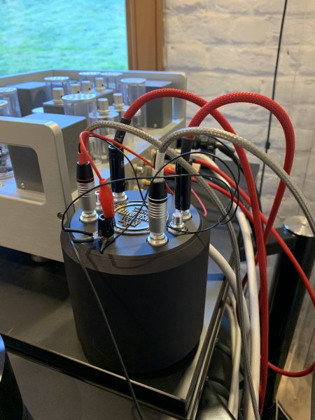

Never do such thing. The goal is to bypass the internal SUT by a much better one. My Allnic H3000V phono stage is fitted within an internal SUT and I have a bespoke SUT built by Consolidated Audio to match the specs of my cartridge.

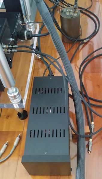

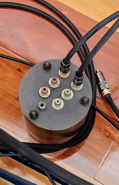

The older version of Emia SUT looks similar.
