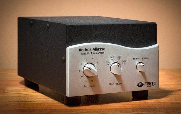

daytona600
Sep 9, 2012
727
154
955
scotland
Zesto make one to cover all ratios
