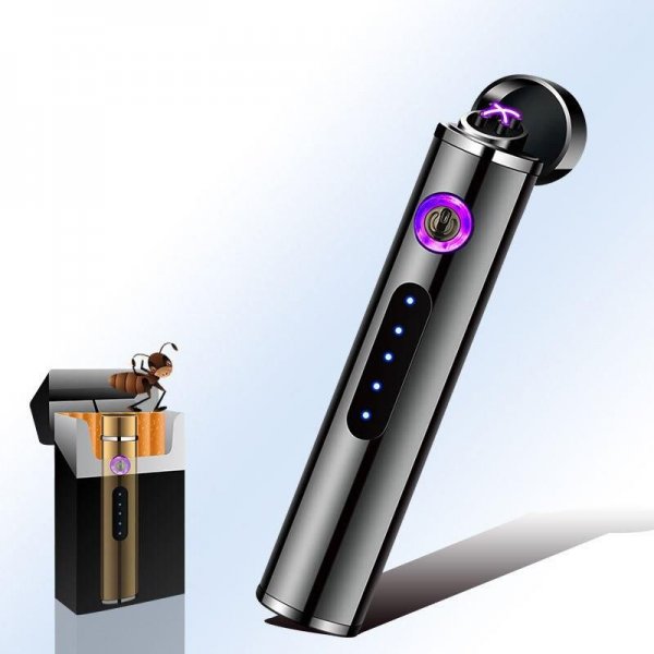

Would this work as well?
Vienna
Yes of course, what matters is the positive charged ions which are being emitted from the plasma charge
kodomo
Apr 26, 2017
1,004
1,615
330
Thanks, I ordered one. I asked because the one you have shared has one arc, whereas the one I am buying has two :)
