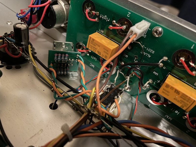

Here is a photo of the impedance switch (Box with 8 resistors). Looking inside now, the mod will be easy. I also see other opportunities to simplify the signal path, albeit reducing the flexibility of the unit. I don't plan on upgrading my phonostage for a few years, I might take this opportunity to do a few things.
I have the same phono and just use the MM INPUT, I have been advised that this input 47kohm does not have a resistor in place as its direct, is this not the case? if so Iam keen to get a zfoil 47kohm one and solder in place.
I believe all the inputs go through the resistor switch. If you look at my picture, there is a header (black box) to the right that all the inputs connect into and the output is paralleled with the resistor switch.
Yes it does ,so it looks like there is a 47kohm for the left and right channel which corresponds to the other resistors that are left for the other values being 10,20,33kohm x 2 So the guys that are using their SUT are actually going through a stock 47kohm resistor too?
