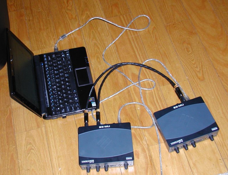

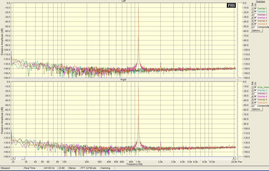

Marlene,
Nice to welcome you to WBF. Although I would like to stay away from any discussion on which is the true on sonic aspects, as IMHO there is not a chance that we can correlate these measurements with sound, I would like to point a few aspects. Considering your data I find that the possibility presented by Amir (power issues) more plausible because of the difference in second harmonic distortion between fig3 and 4 of you blog. IMHO only a difference in power can have this consequence. Noise issues are not systematic enough to allow any conclusion.
Just for fun, I have carried a few measurements similar to yours using a single EMU USB 202 tracker and could not find any difference between all my four USB cables, from cheap looking costing less than USD 2 to decent ones as shown in the pictures, but no audiophile USBs. To simulate even worst conditions I even inserted an extra 2m USB extender cable in the system.
I repeated the measurements using a second EMU unit as a source and could see some differences in noise floor between one and two units results, mainly differences due to mains harmonics depending more on cable layout that on cable type. As soon as I moved everything out of my desk, in a floor zone far away from computers and electrical appliances, and optimized the layout, the differences between one or two EMUs vanished.
Please see the attached figures. At the levels we are talking about, in a noisy environment, everything matters.
Marlene
Jan 25, 2012
5
Marlene,
