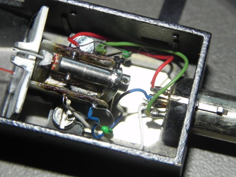

thats why EMT TSD 15 have cap installed on this cartridge, with that ruler flat from 20hz-20khz kills the stylustip and cantilever resonance at 10khz.;)
Atmasphere
May 4, 2010
2,376
1,867
1,760
St. Paul, MN
www.atma-sphere.com
Westerex did something similar in their model 3D cutter heads (used by both RCA and Mercury during their golden age) to reduce resonance in the audio band. Cutter heads tend to have a high frequency resonance, which is why they have feedback windings on the head, used to control that resonance, in addition to the cap. Tthe feedback is also used to improve channel seperation.
But the resonance of any LOMC cartridge and tonearm cable I'm talking about might be anywhere from 100KHz to 2MHz and not affected by that capacitor.
For example if the inductance of the cartridge is 16mH and the tonearm cable has 20pF/foot and is a meter long, the resonant frequency is about 140KHz. Even though the cartridge won't get anywhere near that, its energy can nevertheless set that resonance into excitation- imagine a 140KHz signal that is about 30dB higher in level than the output of the cartridge! That can really mess with an audio circuit designed for high gain high sensitivity unless steps are taken to prevent it! If that signal overloads the input of the phono circuit, it can result in a tick or a pop until the circuit recovers.
