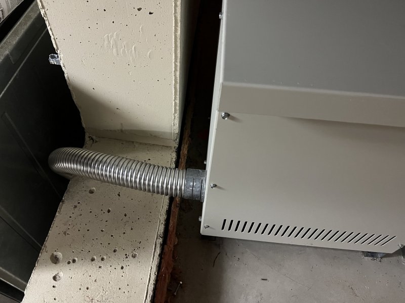

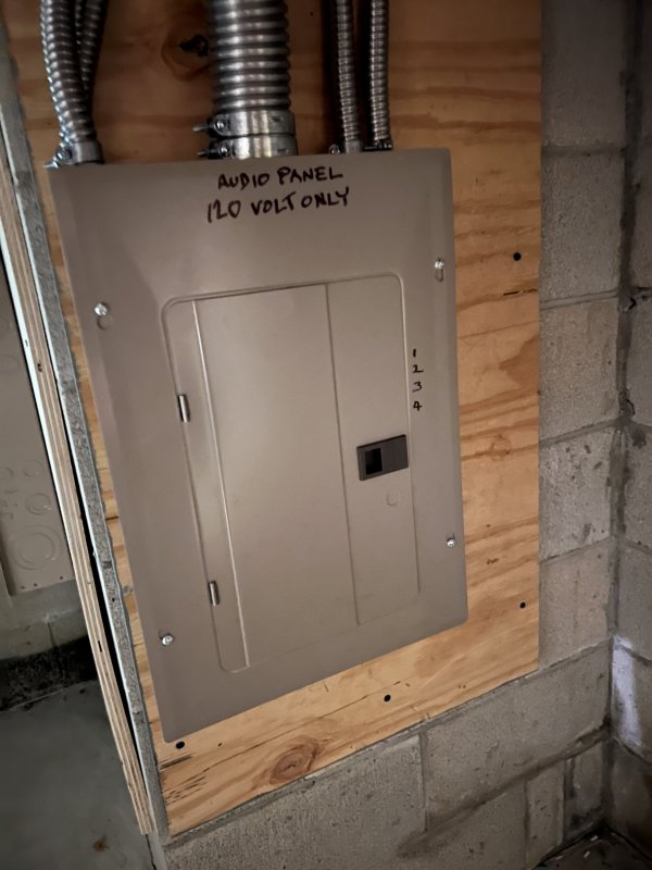

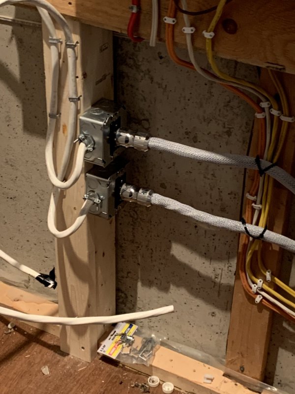

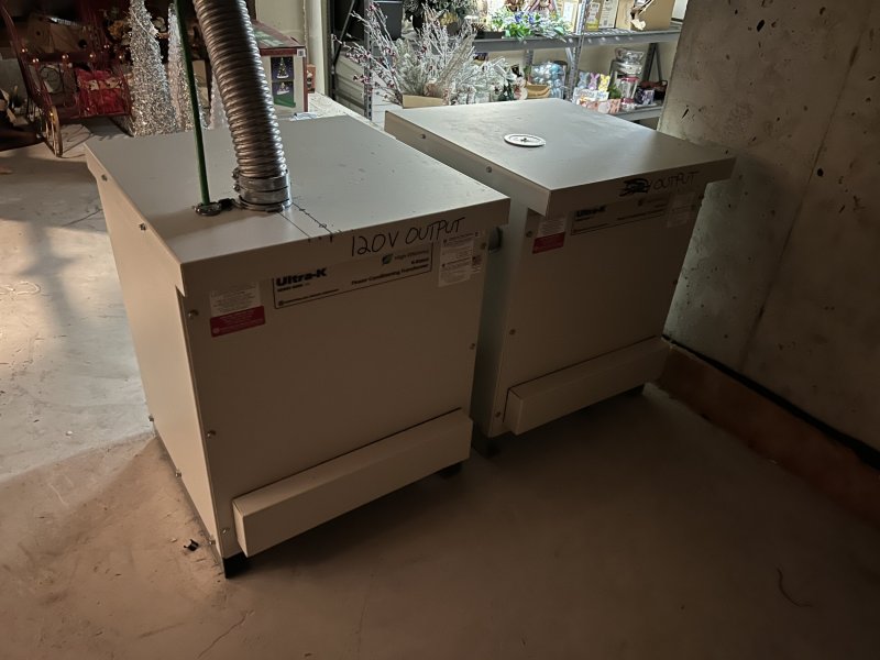

No … but I ran three 10-gauge dedicated wire runs (about 75 feet) to my dedicated audio outlets for about 6 months … then reran it with twisted 8-gauge and I immediately heard the difference. Fuller, clearer, better everything …
I had very noisy power FWIW … quite the project
Reactions: Audire
Avidlistener
Feb 18, 2013
159
65
933
Can you tell us more about the 8 gauge ? We’re you using a sub panel, or was it stepped down?
gds7368
Jan 9, 2015
217
190
420
Direct from the house main power … dedicated electrical sub-panel … into two power transformers in series … separate dedicated ground rods … out to the audio outlets.
Now the audio circuit is split off from the noise of the house electric … followed Vince’s white paper.
My electrician was ready to shoot me by the end but it was well worth all his hard effort. We listened to Fleetwood Mac when it was all done and even he immediately appreciated the difference!

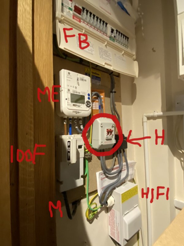

Can anyone in UK tell me what is the circled box in this picture? It's my mains set-up: FB - main fuse board; ME - meter; 100F - 100A fuse; M - incoming mains cable; H - Henley blocks to split mains tails into hifi consumer unit; HIFI - dedicated board with 2 radials out to double sockets. Thx.
Looks like a secondary mains breaker going to what looks like a sub panel. Red, or sometimes black switches seem to be universal in terms of main power kill switches. You can see that this switch is in front of other things. What is connected to that end of the electrical circuit. It reminds me of a sub panel.
The main fuse box connects to it and the dedicated consumer unit. It just seems like an unnecessary secondary switching unit given there's also a 100amp fuse box. I guess it's to comply with UK regs.
