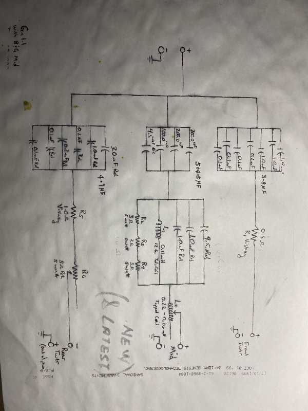

I have found in my PC a few shematics that I supposed to be the related to the GENESIS 2.5 Bass amplifier: Power Supply, Amplifier section and Active Filtering section.
I have uploaded it on my website and you can download it here:
https://www.threshold-lovers.com/telechargement/
If you are interested by these schematics, I should have the paper copies somewhere (?) and try to make better scans...
Just let me know,
Have a nice day,
Michel
Just let me know,
Have a nice day,
Michel

I am the proud owner of a pair Genesis 200 and I hope the schematics also work for the first generation amp provided with this pair of speakers.
In any case: Very many thanks for prodviding this schematics.
