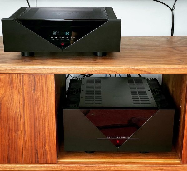

Quick update with a couple pics from the current setup, also on my Instagram with some comments. The Essence are working quite nicely with the Furutech cables I have for review. I’m ordering a DPS-4.1 power cord with 20A plugs on both ends for the amp.
Re: the Zena DAC, it’s sounding better but I’m still not sure I like most Sabre-based DACs... I think I should give it a few hundred hours though as in my experience most digital gear takes an eternity to break in. Pandora and Philip did advise that realistically no built in DAC would be comparable to a high quality stand-alone unit and so far my experience aligns with that.

Lovely looking set-up, Taww. What are the speakers?

Hi @eagle3333 - thanks, the speakers are Audiovector SR 6 Avantgarde Arreté ($25k), which I’ve had since early April (good timing with shelter-in-place). Initial review will be up on the blog soon; I have some listening notes posted from my dealer audition. Audiovector is a fellow Dane and they used to show with Naim a lot but allegedly with Naim now having the same EU distributor as Focal they were less keen to feature another speaker, so AV moved on to Gryphon. (I can’t remember if you or another Gryphon owner here was also formerly with Naim.) I believe they are currently use the Zena + Antileon EVO in their showroom.
I’m starting to get a sense of the individual character of the Essence pieces, having swapped amps once or twice. My other amps are both Class A, the Pass XA30.5 and Valvet A4 Mk.II, both lovely amps. I would say that the Essence pre holds the stronger “sound” of the two, not that it’s overtly colored but it has more of the recognizable Gryphon house sound which I can best describe as “chocolatey“ but pure, and is truly transformative vs. the Pass XP10 or Valvet Soulshine (tubes) which I had at one point. The upper frequencies are so pristine, it really opens up the presentation of all my amps.
The Essence amp, OTOH, strikes me as very, very neutral - I haven’t hooked it up to my Pass preamp but I suspect such a setup would have little to none of the chocolatey-ness. Instead you get a very true view of the signal, delivered in a natural vs. analytical way. While it’s been a while since I had the Bryston 4B Cubed, I think the Essence amp is potentially even more uncolored than that pro/studio-heritage gear, but with greater resolution and less electronic artifact. This might disappoint those seeking more rose-colored glasses, and I think speaker matching might be a little different from, say, the Diablo or Antileon. Similarly, bass heads might want for more overt LF energy - it’s very deep and controlled, but subtle. Similar to my Furutech cables, it has this “sneak up“ effect where it won’t call attention to itself until something like a piano left hand or trombone enters the picture with lifelike weight and resonance. I like it, but the Audiovectors seemed to have more bloom with the Diablo.
I’ll save further observations for my first-take review on the blog, stay tuned. :)
