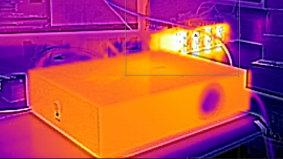

This is what the amplifier looks like when it delivers 800W continuous power for 2 hours:
