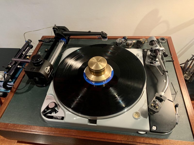

I recently helped my good friend Adam to mount a Kuzma Airline on a Thorens TD124, and with a suitable cartridge of course everything has to be considered , it is no doubt finest I have ever heard a TD124 ever just so incredibly musical and well balanced and yes it does bass too he has been using the Airline now with the 124 for over 5 months with no hassle what so ever. And sound for pound Adam not doubt has got value for money and he could have spent so much more and not got anywhere the performance but yes he has to stay dedicated but he has not the knack of it quite quickly I have suggested a few times I will take the Airline back and give him something else and he always responds no way as he knows its performance is very special.

Mik indeed, kindly held my hand through the instillation and set up of the Kuzma Air line on my TD124 MKII.
It was a daunting prospect at first and Wife acceptance factor of = 0...:rolleyes:
With Mik's expertise and vast experience it's been a dream to use and next to no maintenance to date. I am not fastidiously clean either but dust hasn't been a factor to date. Foot fall is a problem on a suspended floor, so that is a big consideration, but Mik assures me this is so when using any linear tracker. Bounding dogs are not a great combo..
So a pretty unique approach, Thorens 124 MKII and the Kuzma Air line and I have to say I am so pleased with the results.
As Mik mentions in his post the tonearm cable is a compromise on performance but one which can be navigated with some thought.
Along with the many other small mods to the turntable (thanks Tom Montesquieu) and the wonderful LFD cables (it all matters!) the TD124 and Air line combo gives authority, timing, pitch stability, a mid range which I think is just wonderful especially with horns and the air and space that I assume the Air line excels at.
Yes it's a faff sometimes to switch the compressor on (resides in another room and only occasionally turn it off for a rest) but I actually enjoy the ritual, along with selecting a record, all part of the Vinyl replay experience.
A big public thank you to Mik. He introduced me to an avenue of performance I never thought i'd achieve from my collection.
I thought he was bonkers when he suggested the pairing. I am glad he did.
