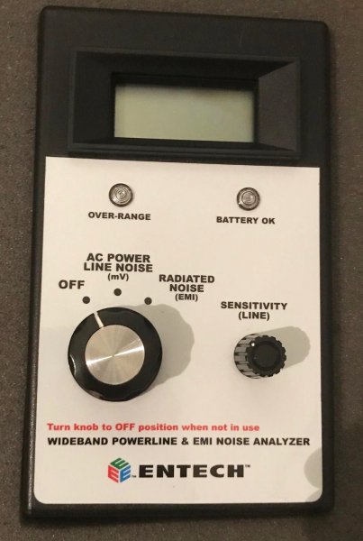

I checked what the BetaBuss (it has a captured cord) does in my sustem with a Entech Noise Sniffer.
This is much better than your A/B comparison.

I have a P.I. Audio Group BUSS Depot (fka BetaBUSS) on order. Pending its arrival I went on eBay and ordered and received one of the Monster Entech Noise Sniffers you mentioned. I left my MIT Z-1 Stabilizer and P.I. Audio Group UberBUSSes plugged in. Following the instructions, I adjusted the Sniffer to read 100 on an "unfiltered" outlet I could easily reach in my kitchen. I then tried various other "unfiltered" outlets in the house and got readings between 90 and 100. That same reading occurred on the companion receptacle in the outlet into which the MIT Z-1 Stabilizer is plugged.
However, when I plugged the Sniffer into a filtered outlet on one of the UberBUSSes in my audio room, it read 0.1. The UberBUSSes are alone seemingly doing an excellent job of filtering out whatever noise the Entech is measuring.
The final arbiter of the sonic effect of such devices is the ear, however. I'll let you know what I hear once I receive the Buss Depot and try it out in place of my MIT Z-1 Stabilizer.

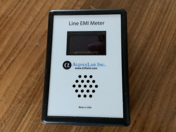

For measuring EMI garbage I use this:
Apart from numbers, you also get a sonic representation of EMI pollution. Unfiltered outlets in my place show results between 200 and 1.800, sometimes even over 2.000. Plugged into the UberBUSS, measurements fall to 40 to 200. I know this type of measurement is quite primitive by professional measuring standards and by some consequently irrelevant, but think it helps to show a basic state of your power line quality.
Have you tried measuring with the BUSS Depot plugged in? Would be interesting to see results.
BUSSDepot OFF:
BUSSDepot ON:
