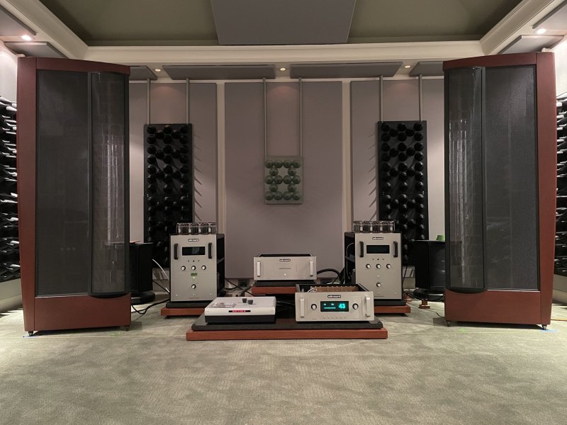

For my part I very much loved my time running my previous CLX Anniversary’s , ARC REF10 , ARC REF250’s
