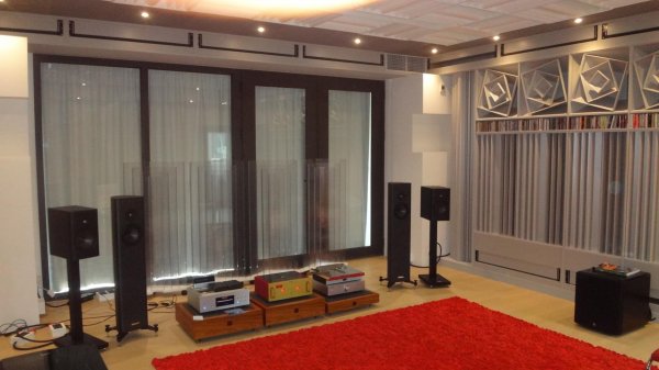

Stereo - how did you manage to solve the doors problem ? Did you install double doors ? If so, how did you decouple the door 'frames' ?
I have double doors on a single, common frame, which unfortunately 'shortens' the walls and decreases the sounproofing.
Yes, double doors and double windows.... The windows have different thickness of glass to have different resonance frequencies.
Each of the doors are rated at 54dB, and I asked for a custom design for better sound insulation in the bass (added mass and filled in frame with concrete).
A common frame would completely kill the box in box. The frame of the door and window is floating. See below a pic of door frame attachment to outside wall.

A few people asked me how the back of the room is treated. Here a pic: diffusion at the center, helmholtz resonators in the corners (movable) and at the junction between back wall and floor. Behind the diffusers back wall, there is a custom made big bass trap, tuned to 26Hz. See also the S1 on the sides for HT.

How deep is the resonator behind your listening chair ?

That is a lot. It made you sit really close to the diffusers. I remember I read once that diffusers are effective from the minimum distance of some 80cm or so (don't remember the exact number). Maybe the SMT diffusers are different though.
What is your distance to the front speakers ? Did you try to move closer to the front speakers ?
