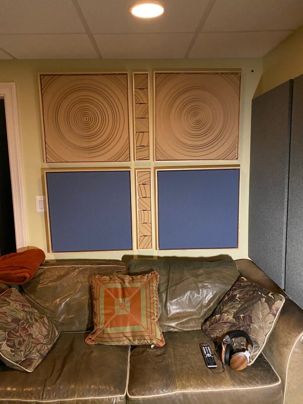

Check out my posts on the ZR Acoustics panels - which just replaced a full suite of RPG BAD and GIK absorption panels which I'd been using for more than a decade in my small (16' x 10') room. ZR Acoustics panels.jpg

Check out my posts on the ZR Acoustics panels - which just replaced a full suite of RPG BAD and GIK absorption panels which I'd been using for more than a decade in my small (16' x 10') room. View attachment 72896
Adding additional ZR Acoustics panels on the front and rear walls has eliminated any residual bass/room mode and other reflection related issues resulting in an expansion of the soundstage and a dramatic increase in clarity. Still have RPG BAD and GIK panels at the sidewall and ceiling first reflection points (because of the high cost of the ZR panels). Amazing to me that these 1" thick panels obviate the need for bass traps and dramatically reduce reflections without deadening the room the way conventional absorbers can - but they do! Note that the blue ZR panels have a thin (1/2") absorptive layer and acoustical fabric over the sculpted wood panels.
Here's the rear wall deployment of ZR Acoustics panels:
