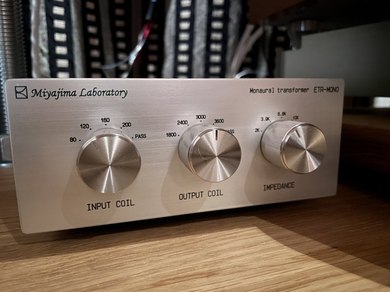

The Miyajima carts also work better with their SUT
Unlike the SPU Mono CG cartridges, Miyajima mono cartridges are quite conventional in electrical terms, and actually work well with other SUTs with optimum gain, but of course Miyajima's SUTs are always a good choice. I am presently running my Miyajima Zero Mono B through a Phasemation 1:20 SUT, employing RCA 'Y' adapters to keep things truly mono, and the listening experience is very good indeed.
