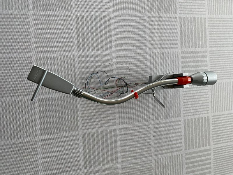

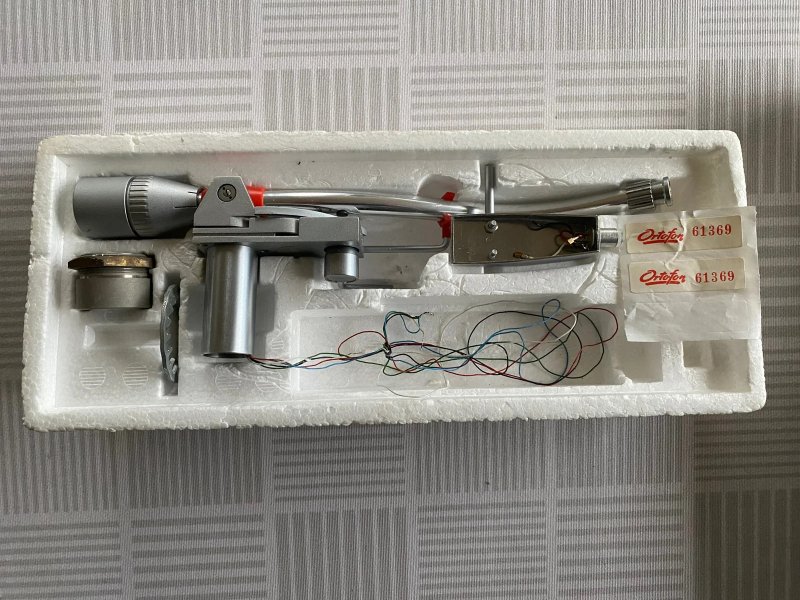

This is my 212 collection - AS-212, RMG-212i and SMG-212
I just bought an AS-212, brand new in box from a friend in Denmark whose father worked assembling Scan Dyna turntables that used AS-212 tonearms. It has been stored in hisfather's drawer since the mid seventies. It is quite rare to find examples with the genuine Ortofon lift installed.
It is now at a friend's shop in the UK ready to be rewired.

Yes, examples of the AS-212 with the genuine lift installed are quite rare. Mine is one of those examples but has also the 5 pin connector ex works installed an no loose cabling
Interesting facts about the AS-212.
All Scan-Dyna versions of the AS212 are with silver counterweight and headshell, orange or light grey plastic parts, original Ortofon lift, short axle for horizontal movement, and flying leads (same production setup as Scan-Dyna). My Breuer Dynamic tonearms also came with flying leads, Ehrard Breuer never liked DIN connectors.
All Telefunken AS212s are without lift, as it is integrated in the player, black counterweight and headshell, extended axle for the horizontal bearings to enable mounting of a lever for the automatic shut off functionality. Plastic parts are black, some different surfaces on the AS212 arm tubing over time, both glossy and satin, polished, anodized and plated as required for the specific surface on the aluminum vary over the years.
The Telefunken S500 uses the AS212, the S600 uses the AS212 MKII, which uses the strengthened base, more suitable for application with external lifts. A very late version of this, apparently features a screw mounted headshell socket.
Scan-Dyna used the AS212's for their 1400-1402 turntable.
Cheers,
