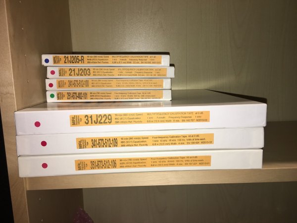

I have a pro that comes and adjusts azimuth, phase etc.... the rest I do myself
I only have SMs or 1. gen copies. all my SMs have 3 test-tones 1K/10K and 100Hz and once in a while I check freq , but I mainly use the MRL tape if I´ve swapped repro boards or anything else that might influence things

Everyone should have a good collection of MRL tapes. Like the above poster said, setting levels and azimuth is not hard. Nick's pre fortunately comes with every adjustment you would need.
