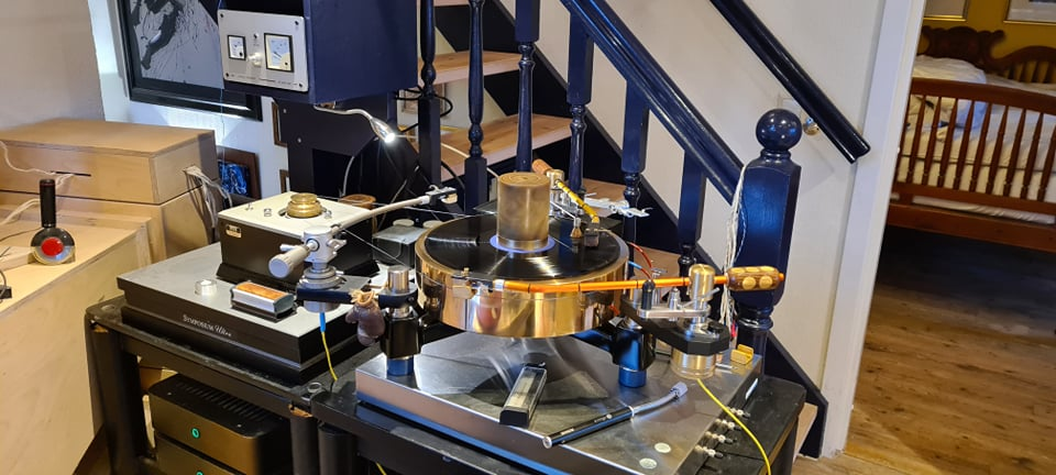

in pic both the stereo and mono are on The Peak from Stefano Bertoncello and the Groovemaster carries the Rowland Complement, but it was only set up this way for comparison purposes and the DaVa certainly sounded at least as good in the Groovemaster

Hi- late entry into this but I was wondering what that clamp is that you are using on the PTP? Just about to order my PTP Solid 12 and I'm a fan of the clamp. Do you find it to have sonic benefits?
Love your table design by the way. Thinking about doing the same thing for mine. Not sure yet!
