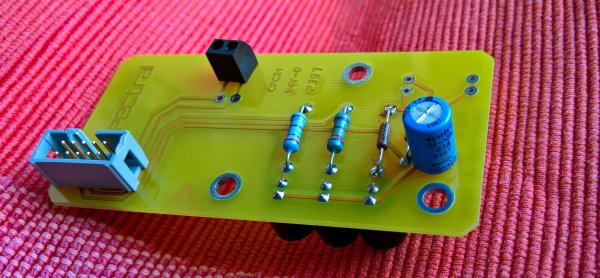

But the best, was replacing the four "ridiculous" rectifier bridges of power supply to voltage amplifier, and customizing a small pcb for ultra fast diodes, that was the biggest difference it made (see pic. 16 and 17).

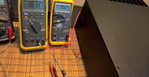

Finally, the adjustments and some simulation tests on the protection circuit. The temperature (with the help of a laser thermometer on the transistor outside the heatsink), fig.5.1, activates the red led. Test protection [DC off-set] with the introduction of a small positive and negative DC voltage (without the speakers), triggers the yellow led, + 2.75V, and -2.9V.
To reduce the noise of the green LED (power ON) was added the same concept that I mentioned here about the relay (XRL-ON), but the mosfet is now a 2N7000. For personal reasons, the lamps "Spectral logo" were removed.

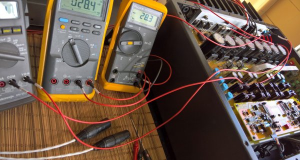

I think Spectral should be the only manufacturer that uses an individual bias system for each power transistor (mosfet). Calibration requires four digital multimeters for each channel and a little patience (Figs. 9 and 10).
When "finished perfectly" the adjust, this is amazing in its sound, especially the focus and silence of the musical instruments, a simply fantastic idea from Mr. Keith O. Johnson & Richard Fryer.
Note; (The choice of bias value was based on many hours of listening, slightly higher than the original value).
The off-set adjustment (fig.11) after three hours was below 2mV (fig.12). This is excellent for an amplifier that has no servo circuit. I think the newer models don't have them either. Personally I am not adept, even well calculated is bad for final performance.

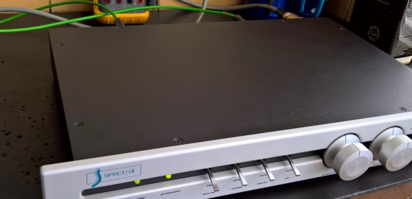

Finally the placement of the feet, and "... music ...."

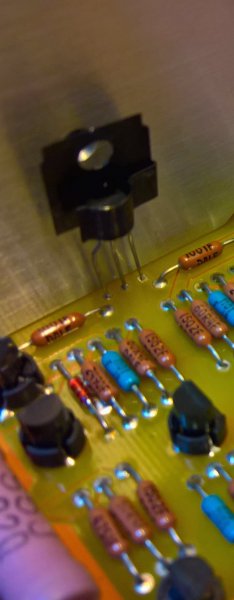

And here's a new challenge for you: see that NPD5566 chip in the preamp board pictures (c3.jpg)? If I recall, it's in the amp's driver board as well. Can you design a better circuit?

I know NPD5566, and the challenge you poses is interesting. If choose an alternative to a DMC 30, the manufacturer would be InterFET ....
