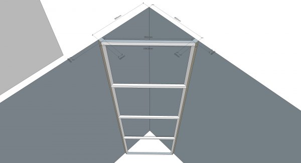

Very easy to build. Just two 50x50mm from floor to ceiling. Then angle cut lateral ones to hold the earthwool. The cover with fabric as you like. Fill with knauf 044 ecosse earthwool.
here it is in 3d, your carpenter can figure it out easily... If you like, make the lateral ones 10mm shallower and you can make a kind of front grill that can easily be put on and off and is easy to cover. If this is not comprehensible, I can draw that for you too.
Think of this like a speaker grill. You have the grill with its frame and fabric and it will cover the trap. You can use anything you like, you can even make it magnetic attachment.

Hi Kodomo,
thank you so much for the detailed drawings. I wonder if the 80cm is a must? Whats the relationship of the depth to the desired bass response? Many thanks!
Hi Kodomo,
As a rule of thumb for porous absorbers, its thickness has to be at least 10th of the wavelength to be effective. I made your basstrap 80cm on the sides, so it reached 56cm depth. This would mean it will be effective down to 53hz as 53hz has a wavelength of 5.6meters and 1/10th of 5.6meters is 56cm.
Unless you have an active solution or a resonating membrane this is the actual thickness you need. The active solutions and resonating membranes are for targeting specific frequencies. The bass trap I have suggested would be fully effective down to 56hz. It will also be effective up until your upper midrange but as the corners have more bass accumulation, it will be most effective on those frequencies. Keep in mind it will be effective below 56hz too, not as much but still a lot more than those resonators.
