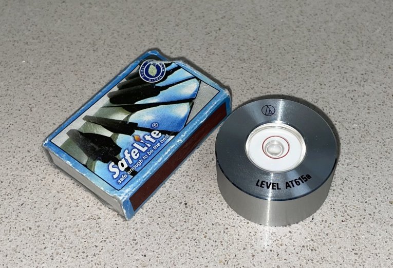

Just had same question contemplating which level to use - i have 4 bubble one and all show a bit different stuff....
One of them is a vintage soviet industrial one - i tend to trust it the most, but i have no way to be sure.
So just ordered DigiPas DWL80PRO + Audio Technica AT615a - will see what they show...
Croc999
Jan 4, 2024
11
4
5
52
Israel
Got Audio Technica AT615a for Amazon.
Accurate it's NOT.
Also - it looks quite chunky, but actually it's pretty light.
So i guess built quality is not the greatest.
Just skip it.
