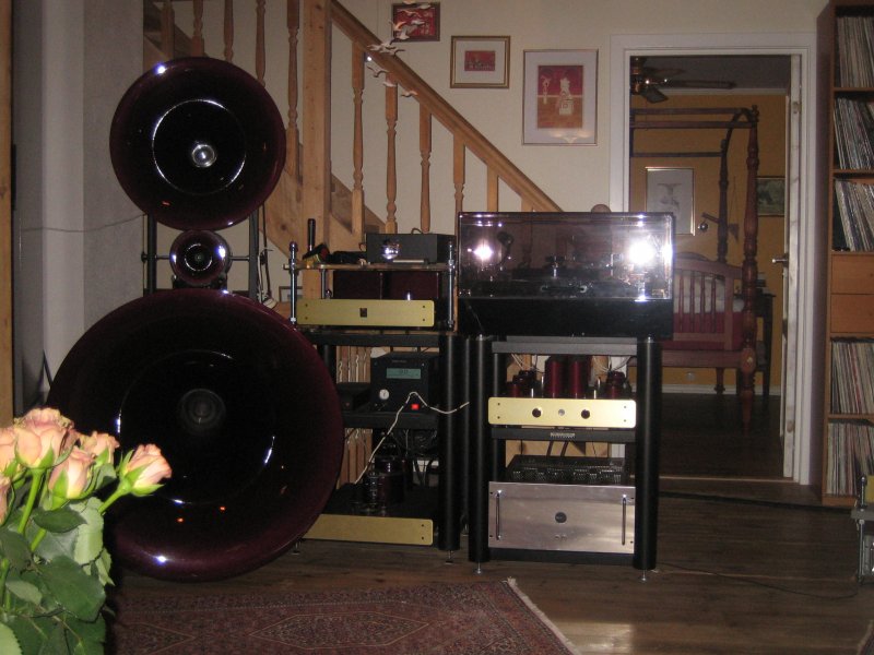

hello Chop
see you have same Trio´s as I had...
tip...the frames are magnetic and the sound improves much by simply leading the speaker wires on the outside of frames and not through
I also lifted midhorns to make room for centering tweeter
sbnx
Mar 28, 2017
1,209
1,361
290
hello Chop

no
main issue with Trio was lobing which was fixed with tweeter
also
midbasshorn has lots of output up to 2K!
that masked and interfered with the midrange horn
we remedied that with a 15µF cap in parallell after the series inductor in the midbass crossover
I had them for 12 years, so I did lots of crazy shit with them
one was replacing cheap Community midrange driver with TAD TD-4001 :eek:
actually at ETF in Berlin they tested TAD 4001 in an Avantgarde Trio "kugelwellenhorn" and it ended up in same league as Klangfilm combo in a shootout

I also made the Trio into "Quattro" by adding a JBL 2405 slot tweeter from 10K
they could be angled for best integration and soundstage, exactly like Living Voice Olympian and their TAD ET-703 tweeters
