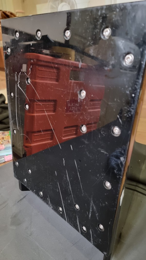

There are no plates at the bottom of the Watt. There are many screws as shown in the picture :(

1
52
