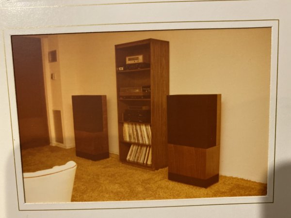

Following law school, in 1977 my wife Marilyn and I moved to Southern Illinois where I briefly practiced law in that area. About this time I entered my Peter Aczel/The Audio Critic phase where I began to pay an inordinate amount of attention to Aczel's reviews and began acquiring some of the equipment he liked. Thus, on our first trip to Nashville, we visited a stereo store where, sad to say, I traded in my Advents and Microstatic tweeters for a pair of the original DCM Time Windows. These actually were quite good sounding speakers, lacking the razor sharpness of the competing Dahlquist DQ-10s the dealer also had on display.
A year later, we moved back to the Chicago area to a Wheaton apartment. While I kept the Time Windows for awhile, I began adding other Audio-Critic-approved items purchased from Quintessence Audio, then run out of founder, Frank Sousa's basement in another nearby suburb. (Quintessence Audio has now become one of the leading audio dealers in Chicogoland, sponsoring several of the largest demo rooms at the annual AXPONA.)
Here are some pictures of that Time Window set up, including one of me basking in its glow--or maybe I'm just guarding the system from prying hands. The earliest of these shots shows my Pioneer SA-9100 integrated amp. Other equipment in the later shots include the BIC Beam Box FM antenna atop the bookcase, my trusty Dynaco FM-5 tuner, an Audionics BT-2 preamp, my Dual 1229 turntable, and a pair of Audionics CC-2 amps.

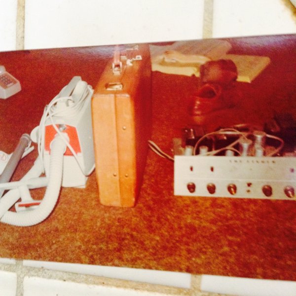

Some of my stuff when in residency, including great 13" TV and typewriter. i built those speakers in my father's garage the first year in college at UC Berkeley. Roberts Reel to Reel, miscellany, Fisher tube integrated. I eventually went to four large Advent speakers with Advent SoundSpace Control.
Also, me in Dental School and one with the tape deck. God, the hair and the mustache, those were the days. A relative sent these pictures after my mother's death.
