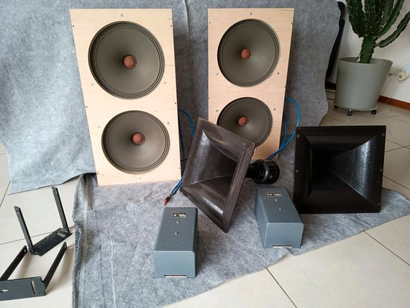

Thats all what you need to build your own bionor sold in Ebay Kleinanzeigen 4 weeks ago. fcbbdda2-4a0c-4408-a873-340030da495e.jpeg
Frequency responce looks good 50-16khz +- 3db right side above diagram

The klangfilm rolls 10 db of at 15 khz .
I assume the top end will sound a bit dull
For the rest its phenomonaly flat / neutral .
You could use it without supertweeter i assume
