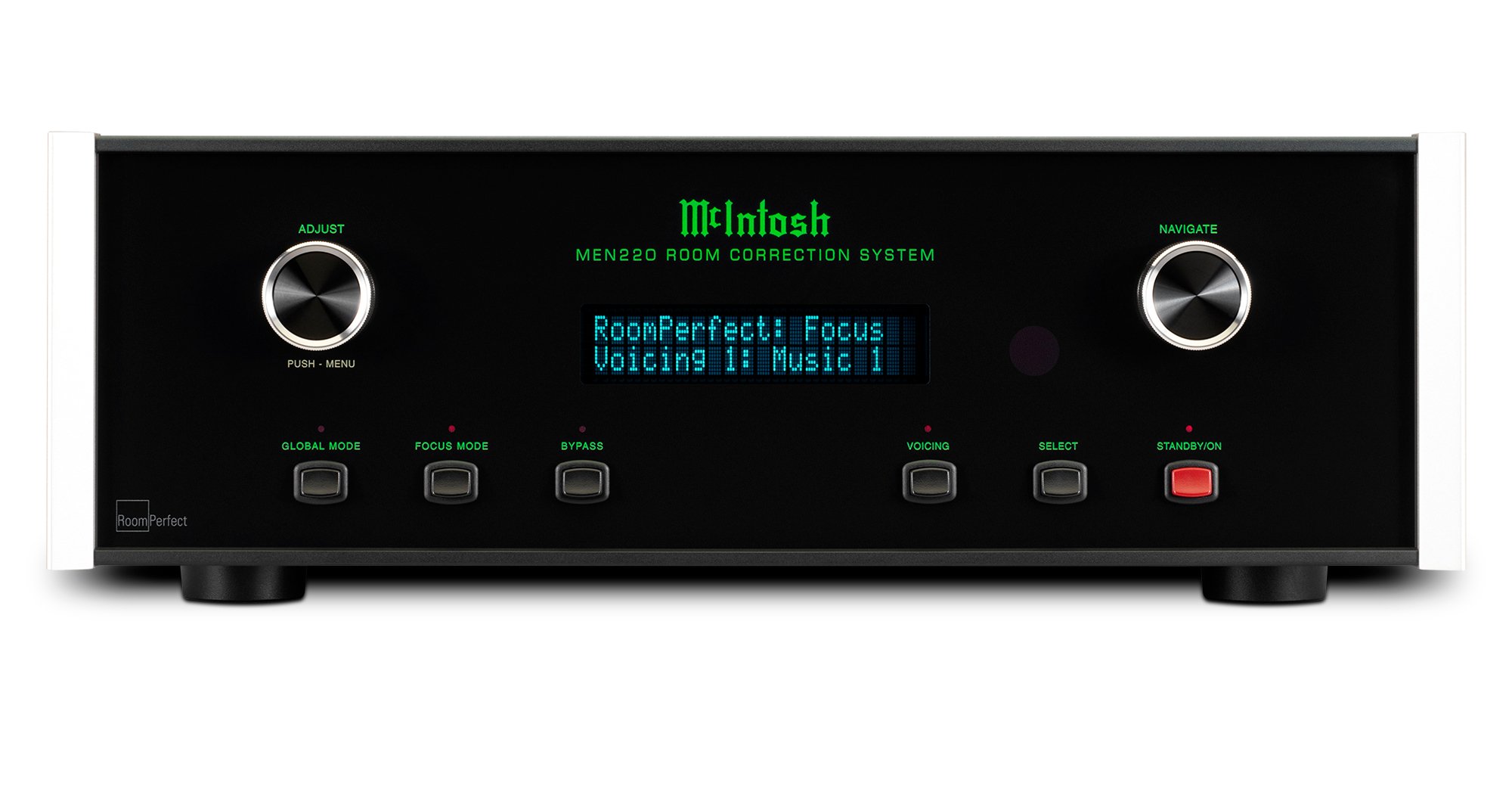

Another FWIW, Linn, McIntosh, Martin Logan and others offer their own sophisticated, room correction. Here’s a link to Linn’s.
English- https://docs.linn.co.uk/wiki/index.php/Guide:Space_Optimisation
There are consultants, as well as dealers, who will come to your system and do the setup. The folks who availed themselves of the Linn system back when Linn still had their own forum gave glowing reports of how much this could help. Many people in the UK have smaller rooms, and so this sort of service was considered quite useful.
I’ll add some other links in a minute.
Here’s McIntosh’s
Here’s Martin Logan’s

But aren't these digital? The thread is focusing on analog EQ.
Digital EQ is, to many, a whole 'nother layer of ew.
i see that now in your title. My favorite analog EQ approaches are those of Rupert Neve. But it takes a lot of skill to use his designs, as good as they are. My thinking is that EQ is EQ. In the end, your goal should be to please yourself. If you feel you need it, then you probably do.
But fix your room first if you can.
