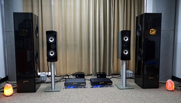

Gary Koh, founder and CEO of Genesis Advanced Technologies, has been working on a new subwoofer, the SuperSub, consisting of two 8" drivers and two 12" drivers and two 15" drivers in one box. Gary's servo control system for the drivers is implemented here.
In Gary's words: “It’s not a 3-way crossover, it’s not that that 15s get the lowest frequency. Instead – I managed to integrate all of this to make each of the drivers (15,12,8) move the same amount of air. The excursion is proportional to the area of the cone. It is the most awesome bass I have ever heard. I was nicely surprised.”
It looks like the SuperSub was designed for the Genesis Quartet (successor to the Genesis 200 and 2.2), but it will be interesting to learn if Gary intends this subwoofer to be usable with any full-range loudspeaker.
The SuperSub can be stacked, apparently, to provide four 8" drivers and four 12" drivers and four 15" drivers per side. That would be a whole lot of woofing going on!
Interestingly, I think Gary is using a high-level signal, tapping the main speaker amplifier's output, to drive the SuperSub's amplifier and servo controllers
Please tell us more about this new product, Gary!
What is your design thinking behind this subwoofer, Gary?
Will the different driver sizes permit smoother integration with full-range speakers?
How, mechanically, would two SuperSubs be stacked?
Is the SuperSub intended for use only with Genesis loudspeakers, or is it designed to be able to be integrated with any full-range speaker?

. . . This is a big sub, bigger than i guestimated based on the cone size and photos. From Gary's Technical Specs on his website:
SuperSub (optional): H 41” x W 26” x D 38"
This makes its footprint 82% bigger than an XLF!
It's bigger than I guesstimated from the photos as well!
I hope it's very heavy!

Lloyd, it is interesting that in this configuration Gary has the SuperSubs firing side-to-side rather than front-to-back. Hopefully he can tell us his thinking behind that decision.

Given that Andy Payor has done side-firing woofers for years until only recently, I do wonder as well...
What actually intrigued me the most in this article is that Gary has actually eliminated the 2 woofer towers in this configuration. The main speakers we see are actually part of the Quartet, a 4-tower speaker (6' tall each speaker) which sits directly below the main Genesis Prime massive 7.5' tall x 4' wide 4-tower flagship. But in this case the 2 x 6' sub towers are removed and ONLY the SuperSub is being used (which was originally shown as a further add-on to the Quartet).
Clearly, Gary has designed these to crossover across quite a wide range which is intriguing in terms of flexibility as well...if it can be used either as supplementary to the 2 x 6' sub towers or IN LIEU of them...I suppose that bodes extremely well for their ability to be used with other non-Genesis speaker systems?
But they really are not firing side to side if they’re only playing low frequencies. At the low frequencies they fire in all directions, as the frequencies are MUCH longer than the size of the woofers so the sound goes in all directions.
To a degree (maybe large) but many find that orientation of direction subs face does make a perceived difference at various listening positions.
There is a little bit if power response deviance but it also varies with the type of subwoofer a fair bit.
These are bipolar so they don’t get baffle step loss. They will be pretty even. The simplest way to describe facing them the way they do is space connivence and less reflections from main towers.
