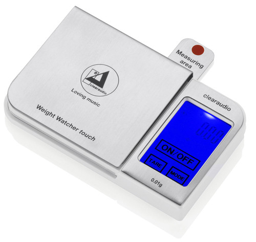

Is the Ortofon one any better or worse than the Clearaudio one? (Or maybe they're both made in the same Chinese factory?)

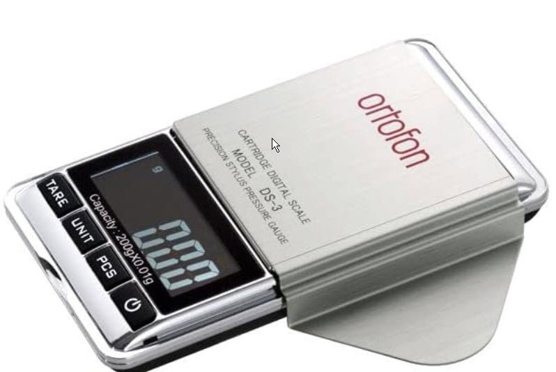

For years I've used the electric Ortofon DS-3. (There is another Ortofon gauge made of plastic, it's not that one.) Used to be you could only buy these out of Japan on ebay but they are now in the US via amazon. I wouldn't pay more than $115 usd.
I use a small 1 gram weight from Troemner, certified calibrated to ASTM E617-13 Class 7 tolerance standards (well la dee da) to test the Ortofon, which said it measured 1.01g.
I like the DS-3 because its measurement platform is closer to record height than most.

I use this one too...accurate enough I would say.

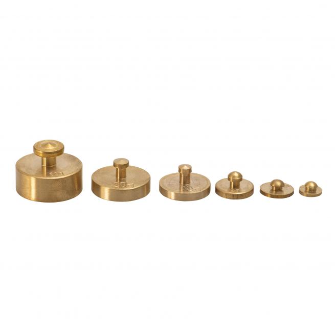

you can actually use any scale.
go to your post office and ask politely if you can get 1 gram and 2 gram weights you want to test your scale. or you buy yourself which then you know if it is accurate. some scales have a calibration function.

Thank you, Tim!

The Clearaudio is over twice the price of the DS-3.

I bought the Riverside gauge and have found it to be as accurate as the Ortofon DS-3 at a fraction of the cost.
