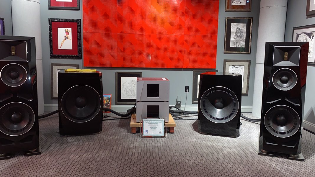

These are the latest product from Gobel called the Divin Sovereign. 18 inch driver, 2600 watt power amp, German made, controllable from your seat via the browser on your phone or tablet, multiple presets and super clean and fast,,,fast...fast
I have other brands this is a SUB ABOVE hahaha ( not the sandwich) Now shipping and available for audition
gian60
Apr 17, 2016
2,508
1,951
343
Listened very well this sub
Never listen in my life a better sub,only the biggest Gobel Aeon line sub can do also better,but 450 kg weight is ……

Wow this is stepping up your sub game!
Yes, really good high efficiency 98db/ 1 watt woofer. Enough power for 40db dynamic impulse. not many subs can do that.
I am not sure that the Aeon subs are better, they should be, but in the situation that these are being used, with the speakers they are being used with and at the price point the Sovereign's are just fantastic. If you own a great speaker and want to make it sound even better these subs will accomplish that. I have nothing bad to say about REL or JL as these are both excellent but this is a step above in both performance, fit , finish, ease of use and of course sound. They also cost more !
