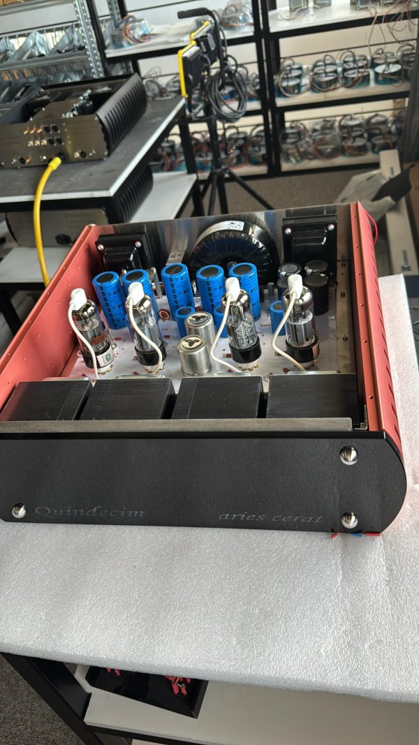

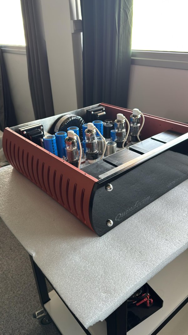

That aside, I recently spent 10 unforgettable days in Cyprus visiting Stavros. While there, I had the chance to audition his latest creations in amplifiers, preamps, and speakers, all set to debut in Munich. It was an experience I’ll never forget.
The Quindecim amplifier left a lasting impression on me. Its sound is nothing short of remarkable, balancing exceptional clarity, transparency, and sweetness with a natural musicality. I was so captivated that I ended up placing an order for one. Though it’s a 15-watt amp, it punches well above its weight, handling speakers with an ease that rivals far more powerful tube amplifiers. There’s an understated elegance to the way it allows the music to flow effortlessly, freeing your mind from analyzing and inviting you to simply enjoy.
This amplifier pairs best with speakers that have higher sensitivity, and anything over 92dB will perform beautifully. While Stavros calls it a “small amplifier,” at a substantial 75 kg, it’s anything but. For what it offers, it stands as one of the finest values in the world of high-end audio.
Here are a few photos I took with the top removed, showcasing the internal components.
