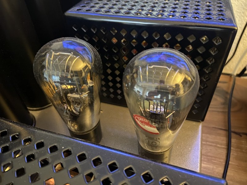

Lets say that I have majority of "best" 10Y and variants options - Radiotron 801 black plates, Radiotron 801 silver plates (both globe and very rare), WE VT25, Taylor Vt25 carbon plates, VT25 normal ones, different ST shape 10Y tubes, Elrog 801 and proudly above all stands 801 globe black plates...all used and tested in my Tobian SC12 preamp...
Lets say that I have majority of "best" 10Y and variants options - Radiotron 801 black plates, Radiotron 801 silver plates (both globe and very rare), WE VT25, Taylor Vt25 carbon plates, VT25 normal ones, different 10Y variants, Elrog 801 and proudly above all stands 801 globe black plates...all used and tested in my Tobian SC12 preamp...

Yes - that is the one i use daily. Can't remember when was the last time I used any of the other ones as this one is just the best one.
TBH Elrog is also great but somewhat in my book behind NOS ones and more expensive on top...but you won't go wrong with WE or Taylor VT25 anyhow.
The western electric is not good in the VT25. I don’t like the Taylor’s either. I compared them, as well as Elrog, Sylvania, and GE. The latter two are the cheaper regular horses if you don’t want to use up your RCA and Cunningham
