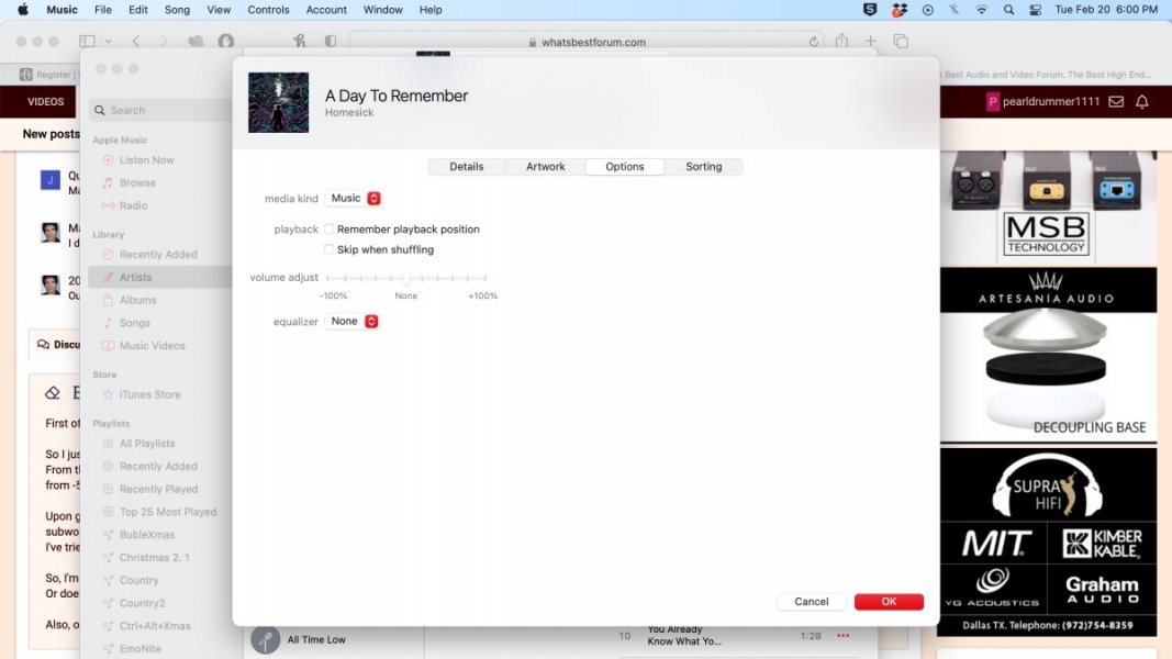

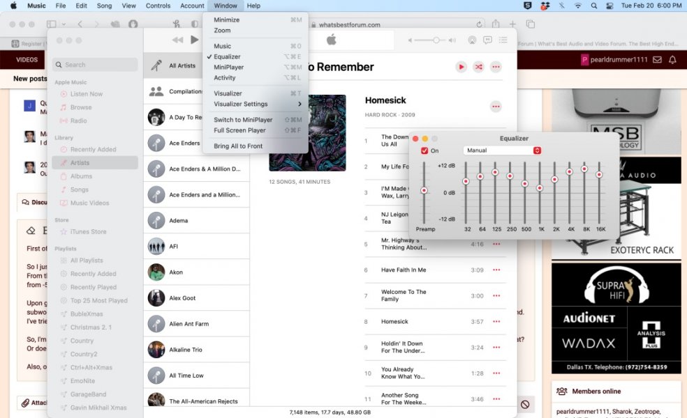

Also, on my iTunes (Apple Music App) on my laptop, I have tried to play with the overall EQ for the whole app (I'll attach a photo) , and that makes a clear difference in sound through my headphones. Does anyone know if I keep the EQ turned on, if I transfer songs to either my iPhone or hypothetical USB-C stick.. will those EQ settings transfer as well? Or do I have to change them on each individual album (I'll attach a photo)? When I turn off the main EQ, and try adjusting on just an album by album basis, it doesn't seem to do anything ( I know the screen shot says 'none' but when I do put it to 'Rock' or anything else, it doesn't have a difference in sound) Am I doing something wrong?

I didn't see it mentioned but what is the format, Bit/Sample Rate of the music files being used? Are they .MP3 files, or are they Lossless files?
Its possible that the Audio system in the new vehicle is much better than the last vehicle and you can now hear all the warts and or lack of quality in certain areas of sound if you happen to be using lower quality music files.
If you have made adjustments on some other device via EQ settings they will not likely transfer to another device since in most cases those adjustments are just taking place to the music as it plays thru the system where those settings were configured.

Thank you for the reply! I should've mentioned the Bit/Sample Rate! That slipped my mind. All of them are .MP3 files either ripped directly from CDs I own, or downloaded from the internet. I'd say the majority of the downloaded ones are 320kbps.
I'd definitely say the new vehicle allows me to hear all the warts and lack of quality for sure; 90s tunes sound much more dull than something that came out anytime in the past decade haha. I figured the EQ settings wouldn't transfer over from the first picture, but wasn't entirely sure if they would or not if I adjusted them individually as shown in the second photo.
