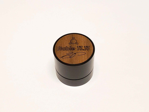

It's not cheap (about US$43), but the Elusive Disc Vinyl Center Hole Reamer is a classy thing to have on your shelf and works very well.
<Edit: It's actually made by Stable 33.33 and available at several online sites>
They say the spec is .286 +.001/-.002 inches. Clearaudio says 7.3 mm which is .2874”. So the 7.3 mm size should always “work.” They do not give the reamer specs, but I’ll bet it’s .287” and I suspect it will always work too. That’s a nice solution too.
The Stable 33 reamer works great and you get a perfectly perpendicular cut. Seems like with a long bit you’d risking a wonky cut unless you can hold it exactly at 90 degrees.
You don’t need a long bit. The interference is cleared with minimal insertion. And once cleared, anyone with reasonable hand eye coordination can withdraw. If one isn’t comfortable with the long bit, just enclose the bit in a longer handle so that a small amount (say .2” to clear .180” vinyl) protrudes.
