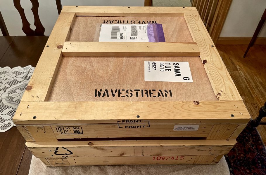

So, on Feb 17, 2021, about two months after I had started this thread, I placed a deposit with Scott Franklin for his most recent Wavestream Kinetic Deluxe Level 5.1 Reference phono amp. His phono amp has always been on my "bucket list". It is an all tube design currently using (2 x 12AX7, 4 x 6DJ8); with extremely low noise ( I believe with the external power supply, noise is below 1uV (one-millionth of a volt ) competing with the best of the solid state phonos; providing 3 front panel selectable inputs = two MC at 62 dB of gain (without the use of SUT’s or FETS) with a useful cartridge range of 0.2mV to 1.2mV and one MM output at 42dB (you are able to choose your MM gain or you can have 3 MC ); having both balanced and RCA inputs and outputs; adjustable loading available on the back panel via custom loading plugs; and an essentially flat RIAA EQ curve within one tenth of a dB (.1dB) from 3 Hz to 40 Khz. *** The above specs are from the best of my recollection - if you have interest, please consult with Scott Frankland to confirm. He is wonderful to communicate with. ***
It is very dynamic, both in the micro and macro sense, throughout the entire frequency range. It produces rich harmonics that are exhilarating when listening to violin/cello/acoustic bass, both reed and brass instruments, vocals, etc... all without sounding syrupy. It is extremely quiet, plenty of gain and very pure sounding with excellent details ... due to not having to use any FET or Solid State devices, and with no need to use Step Up Transformers and their extra set of interconnects and connections or having to fight with hum issues.
It is extremely solidly built with excellent case work, excellent attention to details and a very well thought out design, by an extremely talented designer and a true gentleman who is absolutely fantastic to deal with, Mr Scott Frankland. ( Having a designer that provides excellent support, timely communications and accessibility is just as important to me as finding a SOTA phono amp ). I feel very blessed to be able to have this piece in my system. At $9K new, I feel it is an absolute steal. Certainly priced well below what many people here would even consider to be an ultra high-end piece.... but sadly you would be missing out dearly by passing this one by. Once in a very great while, you might see one come up for sale on the used market, but not very often. I consider this to be a true testament to the greatness of this phono amp as people who own it, hang on to it. It is not a "flavor of the month" type piece, but rather something that you cherish and would like to pass on to your children.
I'll try and post some pic's of it below....

I'm quite sure that the both the Lamm and the Luxman are quite excellent. In fact, there are a great many phono stages available that are wonderful.... what a fantastic time to be into vinyl!
I absolutely love my Wavestream. It puts a smile on my face every day I use it and I can absolutely say that I have No Regrets ;) in adding it to my system.

Thanks for sharing your wonderful story Don. And congratulations on adding such an incredible piece of gear to your system. It very much sounds like this is a phono preamp designed by someone who truly understands what audiophiles want/need in an endgame piece of equipment. And I agree that it looks like great value relative to some other offerings in the high end space.
