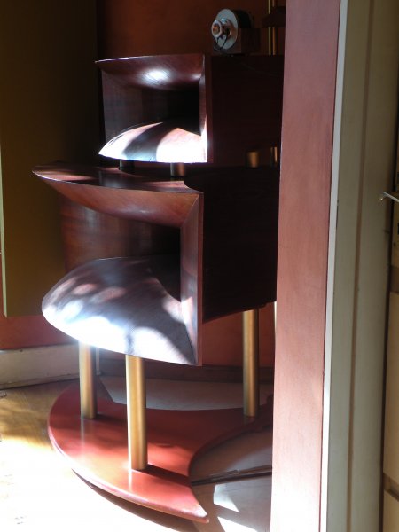

JDZA, omg, those are drop dead scary beautiful horns. For my part I just love the aesthetic physical presence of horns which combines with the saturation of the room w/sound the best ones provide. I do have issues w/the tonality and mids-bass integration of a fair number, but that's a discussion for another thread.
I have to say that your reservation is highly relevant and a massive one counting against me going horns from my Zus.
