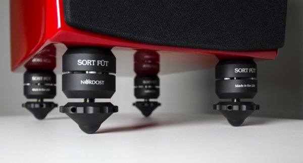

Just discovered these last night. Pretty, clever design that appears to be very easy to level and a lot higher than regular spikes. Probs a lot more solid than wooden blocks. I've found keeping Magicos as stable as possible helps dramatically with imaging.
