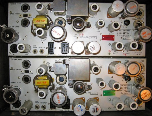

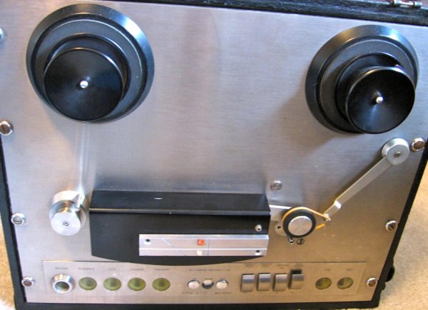

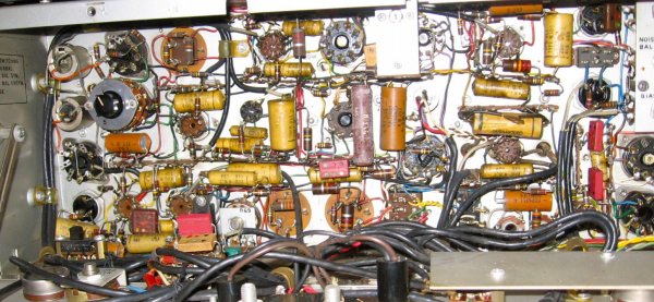

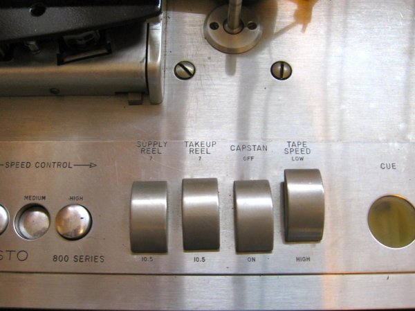

Here is my latest folly. I've always wanted a Presto Tube RTR and finally found one on the east coast. I believe these decks were only made for 2 years when production ended in either 1958 or 1959. They were made in mono full track, 1/4 inch 2 track and 1/2 inch 3 track versions. My technician just made some new cables between the power supplies(dual mono) and preamps today and it fired up nicely. All original from 1957, outside of having new heads installed in 1976. Kara of deHavilland is going to re-bearing the motors and get the final bugs out next month. It is sort of a cross between an Ampex 350 and 351. It has mostly submini tubes(12AX7, 6CG7 and 12AT7) with a final 6BL7 octal output. It is all hard wired with a flip down faceplate that offers nice access to the electronics. I'll post more pics when I get it fully set up. I got it with some Ampex 350 flight cases and have located an original Presto Trolly locally.
I'm looking for a 1/2 inch headstack for this beast. This will likely be harder than finding a needle in a haystack unfortunately.
Not for the Beginner :)

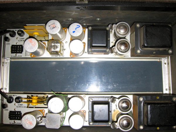

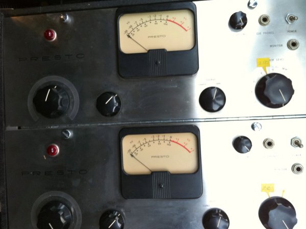

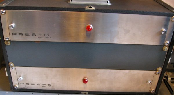

a few more pics of the beast-
note mono power supplies, each with two 6AX5 rectifier tubes. The transport offers 3 different wind speeds and it has user selectable tape tension for both supply and take up reel. These two features were not offered on the Ampex of the day.
Looking forward to hearing how it sounds up against Kara's 351.

Hi Rich, I watched that deck on the auction site for a while. I knew somebody would snag it, I was tempted but I have plenty to do with my Ampexes.
Frank Sinatra had one or two presto 800's and the 1997 Sony "kind of Blue" was redone on a presto 800. The Presto had a different sound than the Ampex. If it were mine I would get John at JRF to build a set of heads for it. It's a pretty piece.
