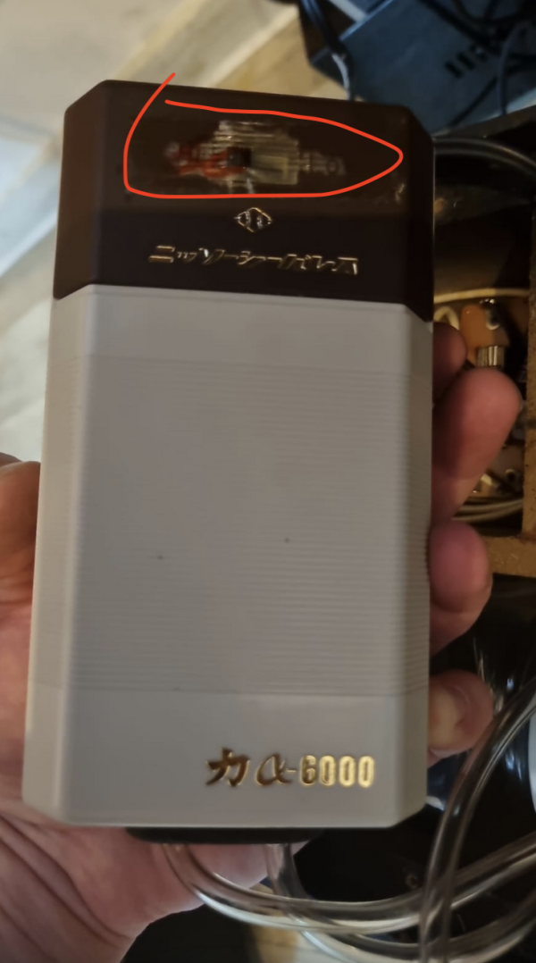

The rp-5070 i have is extremely noisy.
It uses a 'NISSO α-6000' air pump.
I've only found one website who apparently sales 'α-6000' diaphragms but it doesn't appear to be online.
The alternative is to buy diaphragms in Aliexperesss but i'm not sure what the exact size.
Did any one here replaced the diaphragms in a 'NISSO α-6000' air pump and know where or what to buy?
WhatsApp Image 2024-12-26 at 11.41.56.jpegWhatsApp Image 2024-12-26 at 11.41.56 (1).jpegWhatsApp Image 2024-12-26 at 11.41.56 (2).jpeg

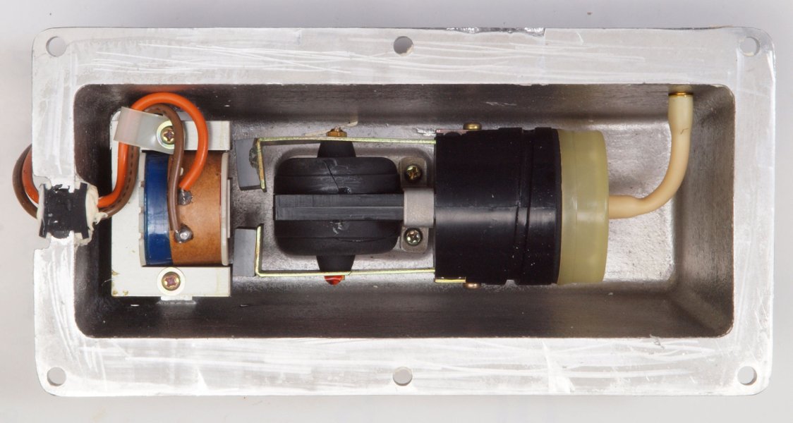

Turns out switching the power setting to "Low" is still enough air being pushed to make the platter spin,
and now the pump is much quieter.
Not bad for 40yr pump :)
just had to remove that 40yr sellotape..

I already ordered the strong pump "made in japan" that can push up to 8Liter /Min,
but judging by the 'NISSO α-6000' specs, 1.5L/M is enough.

I've already replaced the original pump (SSPP-2) in the RP-1090 with a new SSPP-2S.
The suction hold down now is crazy! It pretty much flattens all records.
